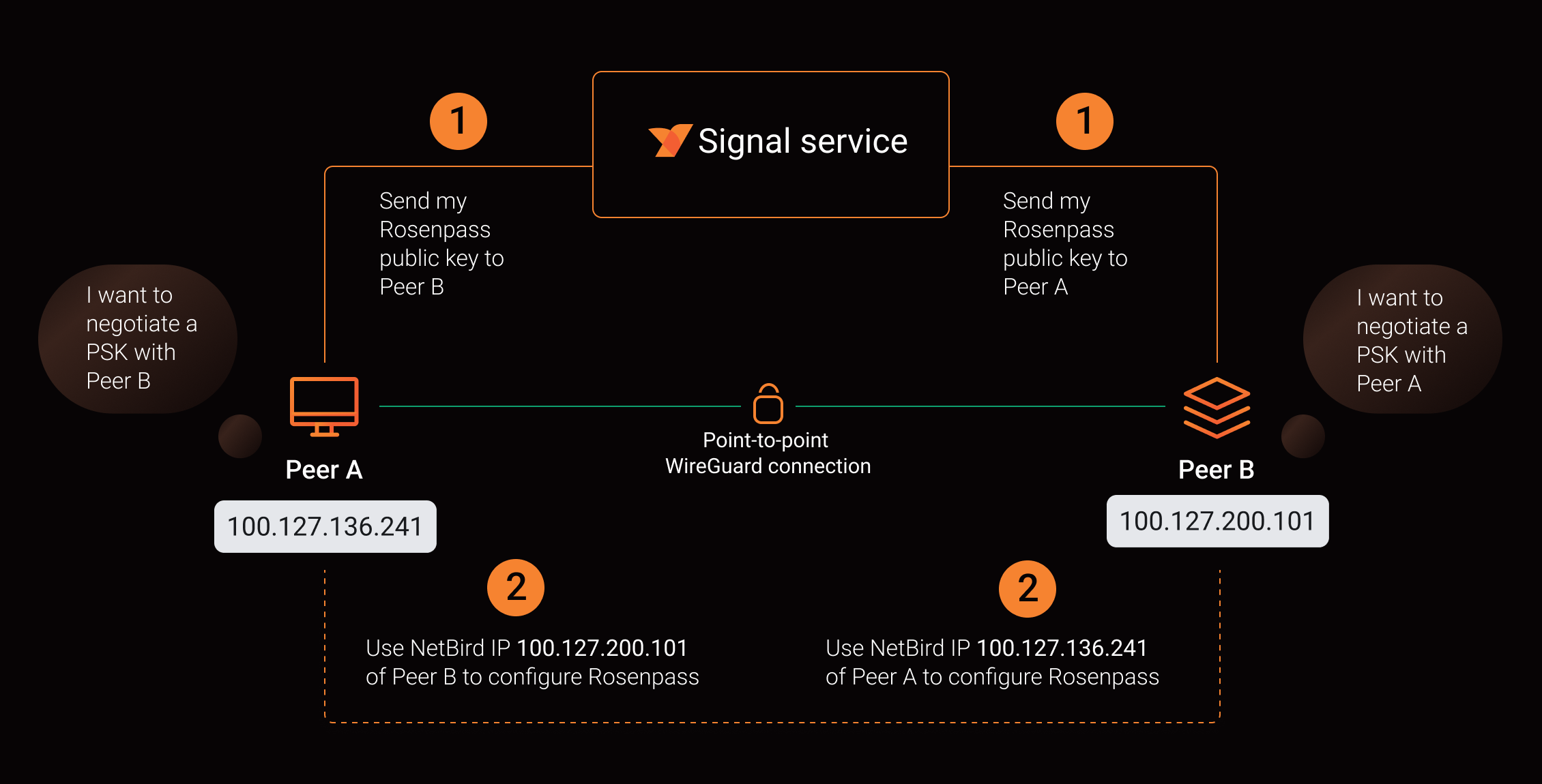

Besides generating a private and public key pair and setting a listen port, the Rosenpass configuration involves extra steps. Like WireGuard, peers using Rosenpass must know each other's public keys. Once again, luck is on our side; we can utilize the signalling service NetBird peers already use to negotiate direct WireGuard connections.

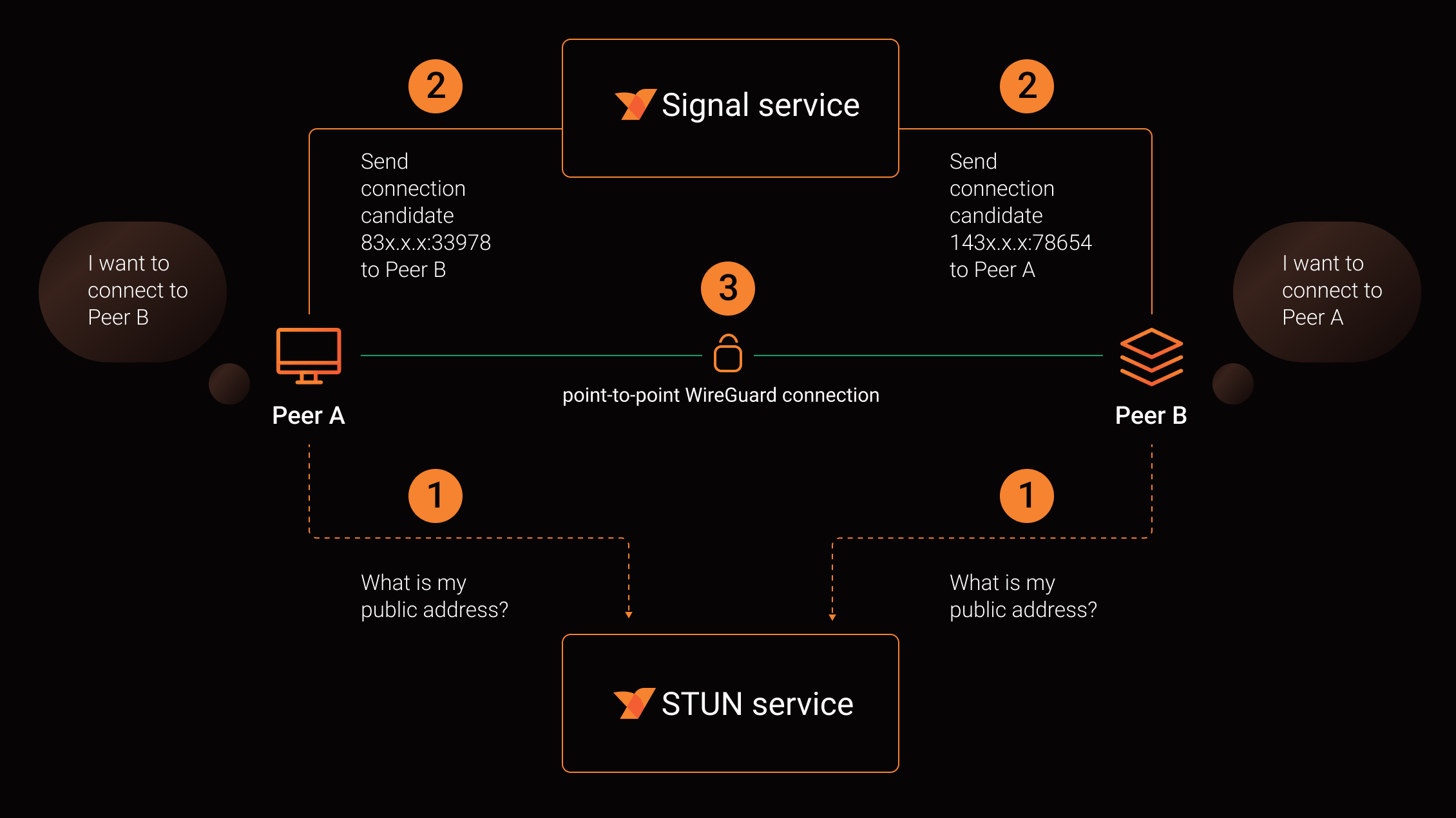

When the NetBird Management service authorizes both machines to establish a connection, the machines initiate a connection negotiation process. They collect a list of all potential connection candidates, including local and public IP addresses (IP: port). Using the Signal service, they exchange these candidates with each other and then proceed to ping these candidates to determine the best available option. The image below illustrates the process:
Extending the Signal service protocol to include a Rosenpass key did the trick. Our machines can now exchange their public keys and add them to the embedded Rosenpass instance.

We chose a simpler method using the already established WireGuard connection between the machines. This strategy involved using the private IPs assigned by NetBird to set up the Rosenpass endpoints. Our process was to allow the standard NetBird connection negotiation to conclude, and then, we configured Rosenpass to work through the established WireGuard tunnel.
To implement this solution, we only needed to add a new callback function to inform the rest of the software once the peers had established a connection. This function configures the Rosenpass endpoint to point to the remote peer using the NetBird's private IP. And once Rosenpass is done with the PSK exchange, we can apply it to WireGuard. Schematically, the Rosenpass configuration process looks like this:
